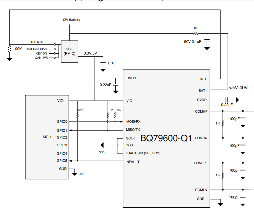

Image 1:
From the above image (taken from datasheet) the necessary changes would be to ground the SCLK, nCS, nUART/SPI pins and connect CVDD pin to 0.22uF capacitor and ground it.

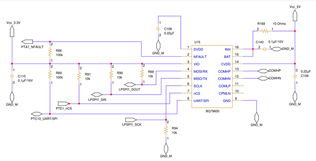

The below image is for SPI mode of communication from my current schematics.

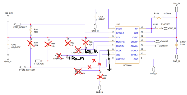

With the above mentioned changes in datasheet image I am planning on doing the below modifications (highlighted in Black for UART and Red for disconnections) where Tx_M and Rx_M are the master Tx and Rx pins.

Since I am using a 5V regulated voltage supply, can someone please confirm whether the changes highlighted in my schematics are okay or are there still some modifications to be done in the schematics like should I isolate the CVDD pin with 0.22uF capacitor to ground or short it to BAT pin?

  • Hi Damodhar,
    Resistors R90 and R88 should be kept. CVDD should be shorted to BAT. This is because CVDD is a voltage stepped down from Vbat to 5V. Since your power supply is already 5V, CVDD should be shorted to Vbat to bypass the stepdown circuit. The rest of the circuit looks correct.
    David
