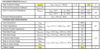

We've got a Vgs waveform of high side MOSFET in buck mode operation, but found there are some ringings during turning on. Engineers worry that drops may cause high power dissipation because the voltages are below Vgs(th) and Vgp.
Could you explain the root cause of ringing, comment on if there is any potential risks and provide solutions to resolve this problem? Thanks!

    I've confirmed that they used the tip and barrel method for the waveforms, and believe that a better layout change can improve the parasitic effect of gate traces to reduce the ringing.
    For this case, we wonder if another cause is Miller Plateau effect from MOSFETs. If so, how do we ensure the switching on and off without potential risks and how to add the snubbers or damping components (the RC snubbers and gate resistors have been added.)? Thanks!
