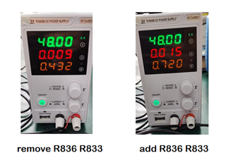

    Change the R815 to 0R and  do the test again, the voltage of R815 is 0.644V and the power consumption has not  changed. We calculate the power dissipation is to read current change of the power supply. When we remove the R836 R833, it can cause 5mA current change  when the power supply is 48V. We also use the highside switch TPS27S100B in our design .The voltage of PIN 1 of BAS21 is almost zero when it enter into  standby mode . There is no power dissipation  problem of the TPS27S100B. Hope it can help!

    In our project, the 48V input voltage is steped down to 12V by LM5145 first ,and then supplies power to TPS272C45D. The picture below  shows the current chagne of power  supply , please check it .
    The TPS272C45D is still work after seeing this behavior.
    We test the current consumption  of TPS272C45D by multimeter when it enter into standby mode. The current is about 1mA . It is really strange, I don't know where the rest of the power goes!
    When add the R836 R833, we remove all around components of  TPS272C45D one by one , only remove R814 R815 and D803, the current of power  supply come back to 9mA.
    It seems that the stange phenomenon is appear when TPS272C45D connect to GND. Please help to analyze this problem ,thank you very much !

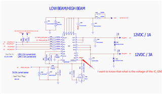

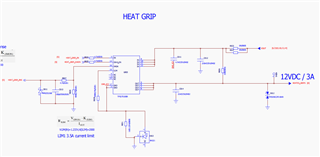

  • Dear   Elizabeth ,
    Sorry to reply now. Please check the schematic in the attachment .5076.schematic.pdf

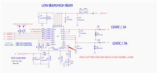

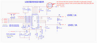

  • Dear  Tim and Elizabeth,
     Thank you for your reply.
    We measure a about 1mA current when the device setup is OFF. please see the picture below  .Thank you all !
  • Hi Fu,
    I do not see any issues with your schematic. What is the granularity of the ammeter being used? Can it detect uA?
    If the VS is being shared with any other devices, that would increase the current draw.
    The TPS272C45 device will only draw up to 3uA under the following condition when the device is off.
    Please provide waveforms probing VS, EN, VOUT, IOUT for the relevant channel to confirm this behavior.

    Please see the attachment. Due to the insufficient number of oscilloscope channels, I tested them separately. We did not add load, so I did not test the Iout. I really want to know what is the voltage  of IC_GND when EN and DIAG is 0V on the EVM board ?  thank you very much !
    5037.waveform.zip

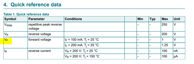

    We would expect the IC_GND to have a voltage offset from module ground equal to the forward voltage drop of the diode used, which would be up to 1.25V in the case of BAS21 (shown below).
    Do note, in your final design, the BAS21 diode specifically is not needed (another diode could be used), and in some cases we advice the BAS21 not be used.
    To elaborate, with regard to ground network recommendations:
    On the reverse side, the diode needs to handle all the reverse standoff voltage you can see. The reason BAS21 was chosen on the EVM was to test ISO standards for the automotive version of the part. If less reverse standoff handling capability is needed, a different diode can be chosen, and another Schottky diode can be used
    The main recommendation is you don't want to see greater than 0.6V on the IC ground pin to ensure you don't unintentionally trigger the loss of ground

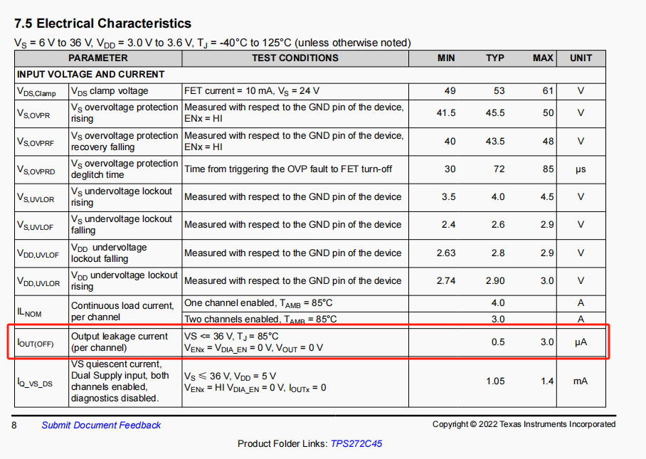

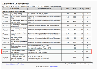

  • Dear   Elizabeth,
    Thank you for your reply .
    According to the SPEC, the max current of  IOUT(OFF) is only 3uA, but in our design ,the current is 1mA. What might be the cause of this phenomenon? thank you very much!
    Allow me to clarify the setup for the Iout(off) specification which is rated up to 3uA.
    This specification was determined by measuring the current from the input to the output when two separate supplies are used (VDD and VS are separate sources), and VEN and VDIAG_EN are low. Under this configuration, there should only be 3uA delivered from the input to the output. This does not account for any internal circuitry powered by VDD as that would be a separate rail.
    I am still uncertain of how you are concluding a 1mA current draw as I do not see any current measurements in the waveforms you have sent over. If you are still using the power supply to measure, it's important to consider this is also powering the LM5145 device which will be drawing current in addition to our device. Additionally if the same supply is used for VS and VDD there will be larger than 3uA of current draw from your supply.
    My recommendation would be to measure the current directly from the VS supply into the VS pin when two independent supplies are used or the current flowing through the output when EN is low. The current measurement from the 48V supply would not be sufficient to isolate the TPS272C45's influence to the current.
