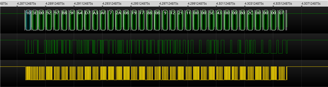

The customer design with BQ76952, This is the host computer captured by the logic analyzer. The data written in PowerConfig register 2D80 is such a long list, which is completely inconsistent with the routine.

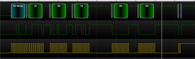

This is the data captured by the  logic analyzer, when writing VCELL_MODE with BQStudio.
What is the reason?
Please help check it.

  • Hi Star,
    I recommend reading the BQ769x2 Software Development Guide for some examples of communicating with the device.

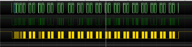

    Could you provide more details about these captures? Specifically what commands the host is trying to send in each capture. Also, it looks like the last capture is zoomed out too much so that the bytes are not fully displayed.
    One thing to note is that bqStudio will normally handle entering and exiting config update mode and sending the checksum when writing to registers. It may appear different due to this.
