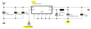

The controller is operated as an inverse converter according to the following circuit diagram:

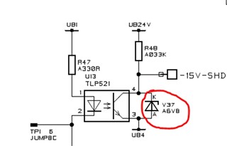

It is controlled by an optocoupler according to the following circuit diagram, since the reference ground of the ON/OFF signal is the floating -15V:
The ON/OFF signal is clamped by means of a Z-diode to 6.8V related to the generated -15V.

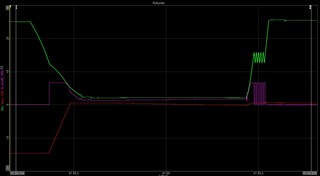

In the recording you can see the voltage at the ON/OFF pin of the switching regulator TL2575.....
The regulator was in operation: voltage at ON/OFF pin at 70 mV.
Afterwards it was switched off: Voltage at ON/OFF pin at 7.5 V.
After that it was switched on but with some jittering. But after jittering, 55 mV are permanently present.
However, the switching regulator does not switch on.
However, we make this observation very sporadically, i.e. less than one in a hundred switching regulators behaves like this.
The x-axis is scaled with 200 ms/div.

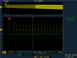

    Some startup issues can occur related to large output capacitance. It looks like there is 1mF of output capacitance on this design. Can you try reducing the value of output capacitance to 100uF and see if the behavior still occurs? Alternatively, if you have the means to measure the inductor current, you can also see if the current limit is being reached.
    When you redo this experiment, measure the SW node, Vin, Vout and ON/OFF if possible.
    Ridge
  • Hi Ridge,
    For inductor current and switch node voltage see below:

    For the schematic, usually there is some bypass capacitance from Vin to -Vout for inverting buck boost topologies. You could try connecting C31 and C34 from Vin to -Vout.

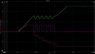

    Vin and Vout are measured to GND. On/off is measured with a differential probe to Vout.
    This is the schematic of test setup:
    See screenshot below for a normal start-up sequence of buck-boost regulator:
    (Time base is 50ms/div.)
    See screenshot below for a faulty start-up sequence of buck-boost regulator:
    (time base is 500ms/div.)

  • Hi Daria,
    Have you been able to test the design with the correct orientation of the bypass capacitor from Vin to -Vout? The "Working with Inverting Buck Boost Converters" shows examples of how the Cio capacitor needs to be configured: https://www.ti.com/lit/an/snva856b/snva856b.pdf
    You may need to smooth the ON/OFF signal. The bouncing could be causing issues.
    Why is the power supply falling during the faulty example? That could be having an impact as well.
