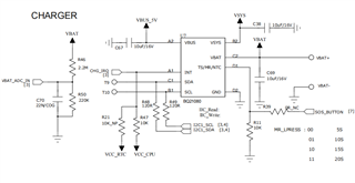

这个芯片在充电过程中会很热,此时充电电流为200mA;在电压跟随模式下,仍然会有热,你能帮忙看看是什么原因造成的吗?

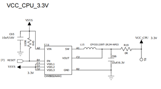

This may lead to your overall power dissipation (charging and powering sys) being a lot for the charger. How much current is being pulled by SYS?
Anthony Pham?
Hi Anthony,
The current on sys pin is about 50mA for a few time ,9mA for most of the time.

If that's the case, I will take some time in lab to take a look at this but generally the BQ21080 has a high thermal resistance. It's recommended to look at the equations listed in the Thermal Protection and Thermal Regulation section for evaluation of this device when thermal performance is a concern.

I will put our schematic and layout below for helping analizing the problem.
