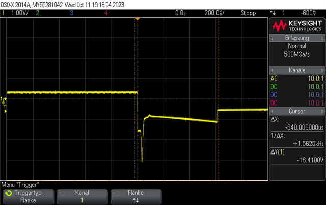

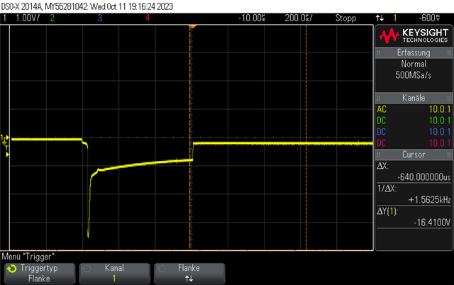

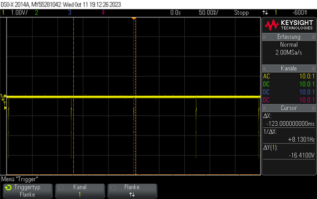

we run several projects with BQ7694000, BQ78350 and BQ 76200. Some PCBs have the strange phenomena, that the capacitors on VDDCP make a ticking noise. When I touch the capacitors on the VDDCP side the noise disappears.
The actual configuration with this phenomena (only one PCB of three): BQ76200 with 12 DSG FETs and 12 CHG FETs (IPTC007 / Infineon) and three 1,5µF MLCC 100V capacitors in parallel. I also tried a fourths capacitor with no change.
