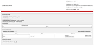

We're using the TPS65987 in a product.  We've selected the W25X05CLSNIGTR as our flash chip.  I've brought out the SPI lines on the TPS65987 EVM and connected them to a programming header on our board to program the flash chip.  Every time I try to program the flash from the TPS6587X-CONFIG GUI, it fails the verification step.  Is there something I need to configure differently in the GUI?  Here are my settings:
