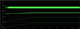

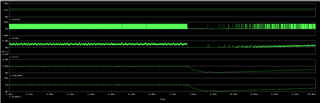

LMR38020-Q1: PSpice Model Issue - Regulator stops switching after 7.5mS
Part Number: LMR38020-Q1
Using the default pspice model and schematic downloaded from the product page, I have extended the simulation time to 10mS but see the regulator stop switching at 7.5mS. Could you guys provide some insight on  why this is and how it can be fixed? My goal is to simulate a load transient but with the regulator stopping at 7.5mS this prevents me from doing so. Appreciate the help and support in advance!
