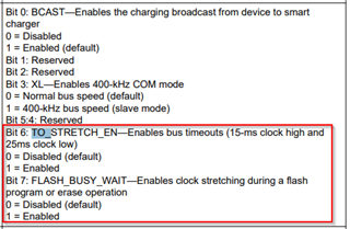

    This could possibly be a clock stretching issue.
    Could you tell me how these bits are currently configured?
    Anthony Baldino
  • Hi Anthony,
    These bits are currently configured as default (both 0)
    Do we need to change these if XL is set high?
    Robert
  • Hi Robert,
    Setting Bit 6 is worth a try, however Bit 7 should always be low.

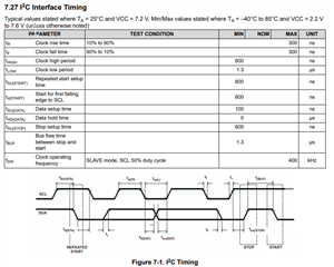

    Also, after taking a look at the data sent earlier, we saw that the final signal is possibly not working because it isn't meeting the start condition seen below where SDA needs to have a falling edge while SCL is high to begin the process seen here:

    Is it possible for you to send a scope capture of the data being read?
    We think one of the timing requirements from the chart above might be getting broken and are trying to narrow down which it is.
