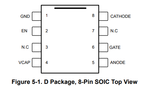

Hi support team,
What is the difference between LM74700-Q1 and LM74700D-Q1?
Does changing the package to "D" allow it to withstand larger input voltages?
(Are the silicon chips inside the same?)
LM74700-Q1 LM74700D-Q1

Input Pins MAX Voltage Abs 65V 70V
Input Pins MAX Voltage ROC
60V 65V
Are there any other differences?
Dice-K
  • Hi Dice-K,
    LM74700D-Q1 can withstand 70V(abs max) and LM74700-Q1 can withstand 65V(abs max). Other than that they only differ in packages and pin configuration with no difference in the functionality.
    PIN1(EN) and PIN2(GND) are swapped
    LM74700-Q1-
    LM74700D-Q1-
