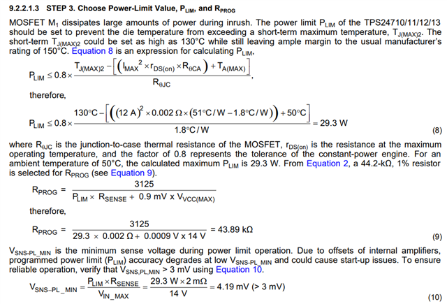

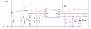

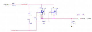

Dear Team,
Regarding the chip TPS24711DGSR, the corresponding MOS model used is CSD16415Q5T. I would like to ask how to set the PROG value specifically and what standards should the power limit setting meet? Can you help me list the detailed calculation process(calculation file)? Thank you~
The schematic diagram is as follows. Problem: The system cannot be started. Reason: The power limit point setting is low.
Attempt 1: Change R3074 to 0Ω, some boards will still be unable to boot. Try 2: Change R3074 to 0Ω, and R3069 from 30k to 22k, and the board will boot normally.
