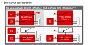

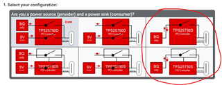

In most of the documentation surrounding the TPS25750 there are more configuration options then exist in the current release (7.0.4.6)
Where are these two options?
This is all I see:
Nate
This is all I see:
Nate
Hi Nate,
The two options you circled are not actually supported by the TPS25750D/S. Those options are source configurations without a 5V path to a DC/DC buck boost converter. We require the 5V from the PP5V path to be able to bias and turn on the gate drivers of the second PPHV or PPEXT power path. The screenshot of the GUI from the documentation looks to be inaccurate. Sorry for the confusion.
Alex
