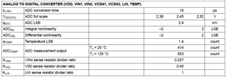

(1) There are three temp sensor in TPS92520, one(let's call it as sensor_A) is situated right in the middle of the part in between the two channels, and the other two(let's call it as sensor_B and sensor_C) are situated in between HS FET and LS FET for each channel. Is this right?
(2) For sensor_A, it is measured and reported to TEMPL/H[9:0], so what is the accuracy of this sensor_A measurement?
(3) For sensor_B and sensor_C, they are used to protect the FET from over-temperature, so what is the threshold for this? Is there hysteresis for this protection? And what is the accuracy of sensor_B and sensor_C?

    1)  You are correct.  Sensor B and C are purely analog temp sensors that are there to protect each channel.
    2)  Sensor A is measured from ADC and those specs are in the datasheet.
    3)  Yes there is hysteresis but I we don't specify it and I will have to research to find out what it is.  The accuracy isn't specified either because it is considered a fault condition when this happens.  Generally speaking, I have found that on the bench it is within a few degrees of what I have measured.
