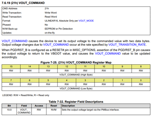

Can the TPSM8D6C24 be used as the core power supply for Agilex FPGAs?
I guess that the PMBus master function of Agilex cannot be controlled unless address 21h (VOUT_COMMAND) and address 8Bh (READ_VOUT) completely match at 1LSB voltage level.
Could you please check if TPSM8D6C24 can match the above address?
21h (VOUT_COMMAND): Datasheet page 64
・8Bh (READ_VOUT): Datasheet page 115
Also, if there are any other precautions to be taken when using the Agilex Core power supply, please let me know.

    We check Intel's checklist for Agilex power requirements. The Intel document no: AN974-757318-757319. Table 5 on page10 lists VOUT_COMMAND, VOUT_MODE and READ_VOUT. The TPSM8D6C24 meets all of the requirements. The TPSM8D6C24 supports VOUT_MODE, allowing the FPGA to read the VOUT_COMMAND and READ_VOUT data format which are always the same. The default is linear16 with an exponent of -9 (512LSB/V) or 1.96mV/LSB.
