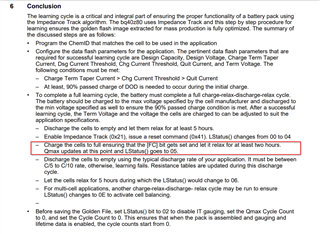

在golden learning完成之后update status=0x05的话是不是代表学习没有成功,请问接下来应该怎么做呢
Update Status 0x05 means Qmax was updated. Resistance table still needs to be updated.
More info can be found in this app note.
