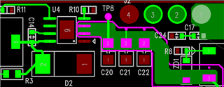

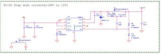

Customer created LM5013-Q1 schematic & artwork.
Please review the schematic & artwork.
For your application, you can refer to our EVM to design layout. For the schematic, the output can add another 22uF capacitor. In addition, a 0.1uF capacitor should be placed between the VIN pin of the chip and ground, and should be as close to the chip pin as possible when laying out the PCB. Thanks.
