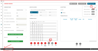

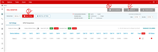

I tried to work SPI Autoaddressing with BQ79600EVM(Bridge) and a BQ79616EVM-021(Stack) on GUI(BQAutoEval)
* BQAutoEval  firmware updated(USB2ANY_3_1_1_14-BQAutoEval.txt)
1. [Success] WakeUp - AUTO ADDRESS - Start Polling  = Hardware and Settings is correct(Just my guess)
[Link] /resized-image/__size/320x240/__key/communityserver-discussions-components-files/196/pastedimage1697086362945v2.png
2. [Fail] WakeUp - WakeUp(Command Sequence)
2-1. when i start, hardware disconnect like this [ img2-1 ]
2-2. So i checked a command happening this problem.
       that is "A0 03 44 00 E1 24" (Dummy Read, Resister Addr 344)
please check my command for autoAddressing and give some ways which thing should i check to solve

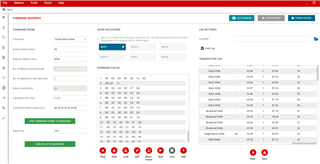

I left my ALL COMMAND and A Image( Command untill Dummy Read, Resister Addr 343 ) [ img2-2 ]

2. A Image ( Command untill Dummy Read, Resister Addr 343 )
/resized-image/__size/320x240/__key/communityserver-discussions-components-files/196/pastedimage1697087586374v4.png
Send   Response
Command   Command Device Address (hex) Register Address (hex) Length CRC Data(hex)
90 00 03 09 20 13 95   Single Device Write 0 03 09 1 13 95 20
DELAY 12
B0 03 43 00 E7 D4   Stack Write - 03 43 1 E7 D4 0
B0 03 44 00 E5 E4   Stack Write - 03 44 1 E5 E4 0
B0 03 45 00 E4 74   Stack Write - 03 45 1 E4 74 0
B0 03 46 00 E4 84   Stack Write - 03 46 1 E4 84 0
B0 03 47 00 E5 14   Stack Write - 03 47 1 E5 14 0
B0 03 48 00 E0 E4   Stack Write - 03 48 1 E0 E4 0
B0 03 49 00 E1 74   Stack Write - 03 49 1 E1 74 0
B0 03 4A 00 E1 84   Stack Write - 03 4A 1 E1 84 0
D0 03 09 01 0F 74   Broadcast Write - 03 09 1 0F 74 1
D0 03 06 00 CB 44   Broadcast Write - 03 06 1 CB 44 0
D0 03 06 01 0A 84   Broadcast Write - 03 06 1 0A 84 1
D0 03 08 02 4E E5   Broadcast Write - 03 08 1 4E E5 2
90 00 03 08 03 53 DC   Single Device Write 0 03 08 1 53 DC 3
A0 03 43 00 E3 14   Stack Read - 03 43 1 E3 14 0
