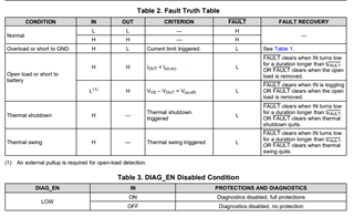

Hi team,
TPS1H000-Q1 cannot determine which fault occurred because it only have a FAULT pin, correct?

Hi Tabata-san,
All recognized faults will respond in the same way on the fault pin and therefore there is no way to distinguish the faults from just the fault pin.
It is possible to recognize what fault has occurred by the context in which the fault is reported with the help on the IN and OUT statuses:
