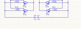

Hello, you will find a schematic design below. Before send this schematic to manufacturer I want to ask couple of quesitons.
1. Is it okay if you can check and tell me if theres something wrong with it.

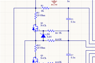

2.  In this pic, you can see R5, 20Ohm resistor. Well the spec of this resistor is 20 Ohm 0.5% 1W 1206. Is it suitable?

4.  Here Im using two capacitors, 0.1uF, 50V, 0603 , Im thinking that if its okay to use 50V capacitors for 20s li-ion battery pack.

    1. The external balancing circuit with NFETs looks okay.  The filter resistor and capacitor values are correct.  The value of the cell balancing resistor (R5, R12) will depend on your target cell balancing current and the voltage of your cells.
    2. Here is the equation to determine what values to use: Rcb + Rdsonexternal = Vcell / ibal     |      After determining these values, you can calculate the specs on the cell balancing resistor, using P = ibal^2 * Rcb
      1. Rcb: cell balancing resistor
      2. Rdsonexternal: ON resistance of the external NFET
      3. Vcell: cell voltage
      4. ibal: desired balancing current
      5. P: power dissipated over the cell balancing resistor

    4. Yes, capacitors rated for 50V should be okay for your application.
