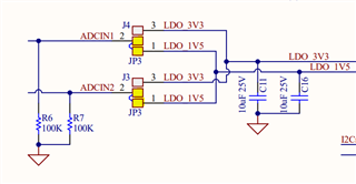

Thanks for your help.USBC Test Fixture.pdf
  • Hi Bruce,
    I took a look at your schematic and the I2Cs signals are routed correctly.
    I know it seems trivial but please make sure you did not accidentally swap the SDA and SCL lines when connecting to the header.

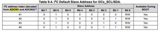

    What I2C address are you using when trying to talk to the TPS25750 over I2Cs using the Aardvark? Your ADCIN I2C address is set to 0x21.

  • Hi Bruce,
    In your schematic, with the indicated jumper configuration, you are shorting ADCIN 1/2 to LDO_1V5. I2C addresses of the PD controller are set by the ADCIN configuration. The options are 0x20, 0x21, 0x22, 0x23.
    0x50 is the I2C address for the EEPROM.
    When you program your board, please keep in mind that the I2C addresses of the PD controller and the EEPROM are not the same. To talk to the PD controller over I2C, you must use the PD's I2C address, which is 0x21 in your case.

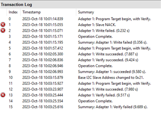

  • Thanks for your help
    0-4 TPS25750 address 0x50          Immediate fail
    5-9 EEPROM directly                       Pass
    10-15 TPS address 0x21                 Pass but fail verify
    #1 When I flash the TI EVM Text fixture with address 0x50 using Test.bin, the clock and data are passed on to the U5 EEPROM.  I verify that with my o-scope.
    #2 When I flash my PCB with address 0x50 using Test.bin, there is no data passed thru the TPS25750 to the EEPROM. Verified with o-scope.
    #3 If I then flash my test PCB EEPROM directly with address 0x50 using Test.bin file, the program verifies, but there is no 5V output. No Data is transmitted at power on.
    #4 If I then flash flash my test PCB TPS25750 with Test.bin, address 0x21, it programs does not verify but I get do get the 5V output. Data is transmitted at power on.
    Note: I have not tried to program the TI EVM using address 0x21.
    I am using theTPS25750 Application Customization tool to generate my Test.bin file.  Is there a different file that is to be used to program the TPS25750?
  • Hi Bruce,
    The I2C address of the TPS25750 is 0x21, the I2C address of the EEPROM is 0x50.
    When flashing the EEPROM directly, you should use address 0x50. For all other cases (patching to PD and flashing to EEPROM through PD), you must use address 0x21.
    When you generate the binary file from the Application Customization tool, please make sure you generate a full flash binary. Also, you can try "Erase" on Aardvark before "Program+Verify". Sometimes erasing first helps the verification succeed.
