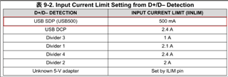

Check the datasheet,
BQ25606 is
When “D+/D- Detection” is SDP, the Input Current Limit is limited to 500mA.
https://www.ti.com/jp/lit/ds/symlink/bq25606.pdf?ts=1697085041637&ref_url=https%253A%252F%252Fwww.ti.com%252Fproduct%252Fja-jp%252FBQ25606

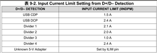

BQ25616 is
This description was not found for Input Current Limit when “D+/D- Detection” is SDP.
www.ti.com/.../bq25616.pdf

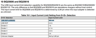

However, after reading the application note, it appears that the above support is provided.
www.ti.com/.../sluaa94.pdf
