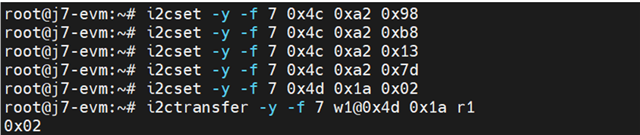

I meet a problem about the CRC fault of I2C1.  We have two PMICs in our project, the part number as below
TPS65941111RWERQ1
TPS65941212RWERQ1

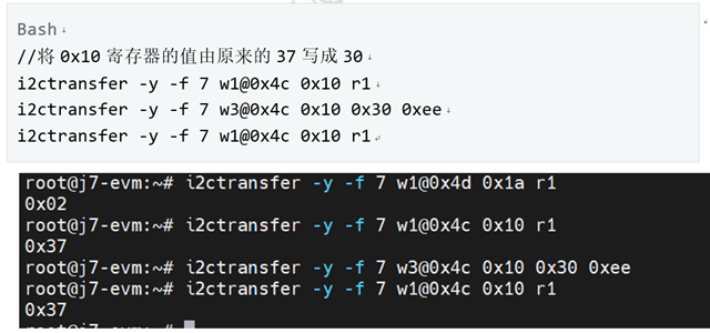

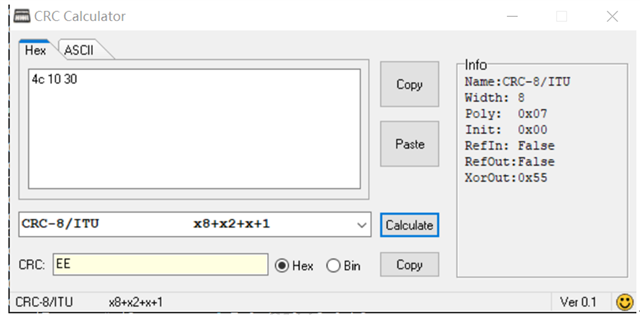

I use same software function to calculate the CRC of I2C1. It works in TPS65941212RWERQ1, but failed in TPS65941111RWERQ1.
And also the PMIC init funcation are same. Do you have any advice about it? Register 6A is 0x02 which COMM_CRC_ERR_INT is set.
Thank you!
