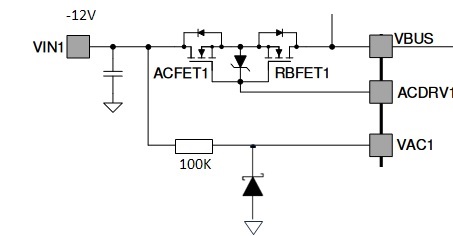

Hi
Can't find any information on how to protect the charger inputs (VBUS) against unwanted reverse polarity connections.
According to the datasheet the VAC input handles -2V max, so VAC needs protection.
Would this solution work (adding a serial resistor and a diode to the VAC input)?
Please review and feel free to propose alternative solutions.
