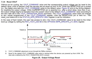

On data sheet 7.3.8, I have some of questions about it.
Could I know the details in datasheet? Thank you!
  1. [Blue line in Figure 26] When Samsung use PMBus, Vout will be boot up from Boot up voltage and communicate with PMBus and settled to default output voltage.
I can see the waveform from Data sheet 7.3.8 Reset Vout. But I need to know the value of voltage drop during (A) duration.
Could I know the voltage drop value during (A)?
  1. [Green line in Figure 26] If Samsung do not use PMBus, Vout dont need to communicate with PMBus. So it looks (A), (B) will not be operated.
Then, What happened on duration from Pre-AVS Vout to Default Output Voltage? Does there voltage drop as well or Are there no voltage drop between them?
