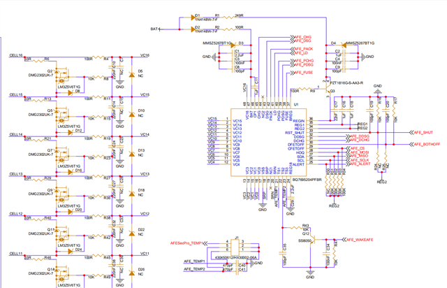

Hi
The customer design with BQ76952, the battery is connected to the inverter, and the inverter is loaded for a 40A discharge.
When a fault occurs, the MCU sends a command to BQ to cut off the charge and discharge MOS, and then controls DFETOFF (configured to turn off the charge and discharge MOS) and makes BQ enter SHUTDOWN mode, and the battery has no output.
When the battery is turned on again, there is no output from the battery.
Attached the register setting and schematic.
Safety Alert A  is 0x00
Safety Status A is 0x00
Safety Alert B is 0x00
Safety Status B is 0x00
Safety Alert C is 0x00
Safety Status C is 0x00
PF Alert A is 0x00
PF Status A is 0x00
PF Alert B is 0x00
PF Status B is 0x00
PF Alert C is 0x00
PF Status C is 0x00
PF Alert D is 0x00
PF Status D is 0x00
battery status  is 0x80
Stack Voltage is 0x12BD
PACK Pin Voltage is 0x0014
LD Pin Voltage is 0x0013
Alarm Raw Status is 0x0683
Internal temperature is 0x0CEE
SCHEMATIC1 _ P04_FETDrive.pdf
Please help check it.
