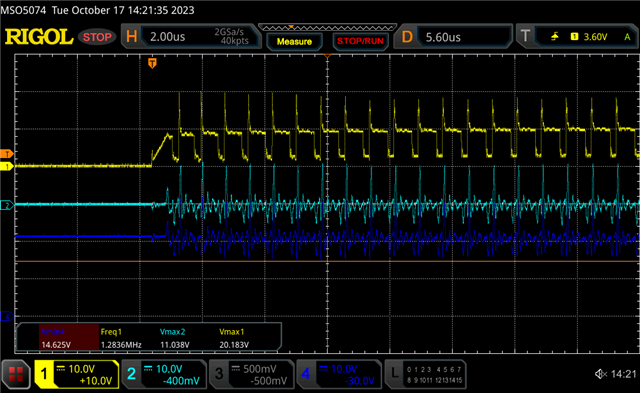

Yellow trace is Gate, light blue is DESAT, dark blue is +20v VDD supply.
Gate is oscillating at ~700ns period. Any idea what's going on here?
All help is appreciated! Thank you!

Hi Josh,
Thanks for reaching out. There can be multiple reasons for ringing on gate which include layout, parasitics, etc.
I would recommend trying the below solutions:
1. Increasing the gate resistance
2. Adding a ferrite bead near the gate of the FET.
Let me know if it helps.
Pratik
