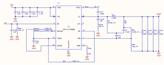

Hi Team,
The TPS53355 in the circuit is used under the following conditions: VIN=12V, Vout=1.03V, Iout max =20.4A.
And the design is as follows:
Note:
a. All capacitors in the above figure are ceramic
b. L1 has a DCR of 1.06 mΩ
c. FSW=750kHz

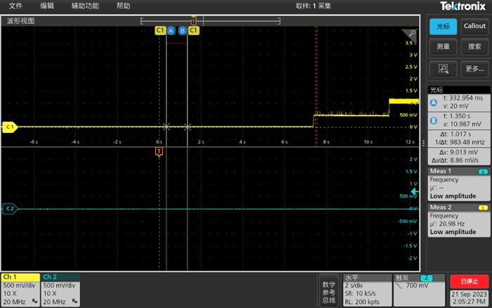

1) Some chips output about 0.5 V after power-up when at cold temperature -40°C, while it will only output the nominal voltage of 1.03 V after a few seconds. The output of the chip is good at normal temperature.
The waveform is as follows:
2) Some chips have dropped after a period of power-up when the temperature is -35℃. The waveform is as follows:
However, the chip can start up normally at low temperature -30℃. The TPS53355 output voltage is not proper, causing the system cannot start at low temperatures.

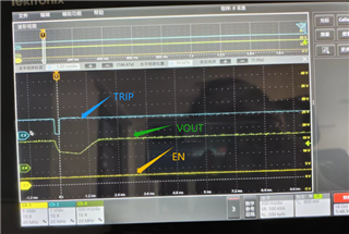

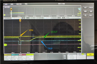

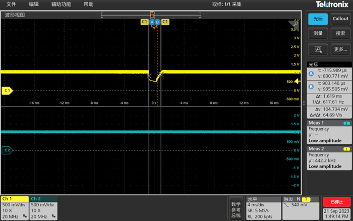

  • 1、when the chip have dropped,the waveform as follows:
    when startup ,the waveform as follows:
    2、layout file as follow
    TPS53355.brd
  • Hi Caleb,
    Thank you for the support!
    Xinjie guo is the end customer and you could continue the discussion here, please let me know if any questions.
    Cherry
  • there is only one drop,no hiccup occurred.
  • Hey Xinjie,
    Thank you for the scope shots. Can you now put replace enable with inductor current, and make the time scale small enough so that we can see the ripple in the inductor at the time that the part shuts down.
    Also, can you give me your value of Rtrip. The schematic attached is too low resolution for me to read.
    Caleb

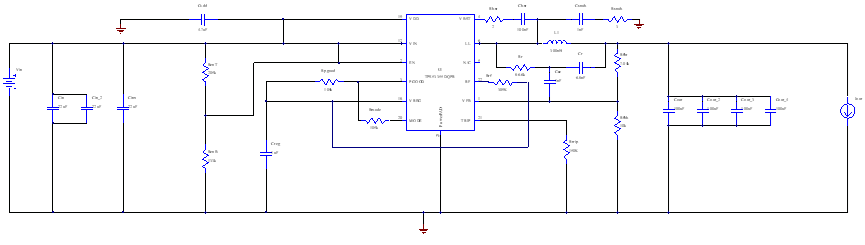

  • Hi
    Rtrip is 150K and the schematic as follow.
    How can I put replace enable with inductor current?What should I do?What equipment do I need to use?

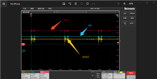

  • Hey Xinjie,
    After speaking to my colleague, we have determined that the part is not shutting down due to a fault. Which means that the part is either undergoing a UVLO shutdown and restart, or an enable toggle.
    The next steps would be to measure EN at a smaller time scale (10us/div) to see if there is a glitch. We are focusing on EN signal since there is no filtering cap. We think there might be a small glitch that is causing the part to reset. If you can't see a glitch on Enable, I recommend disabling any bandwidth limiting you might have active. If you still can't see a glitch on enable, then check VIN with the same division settings.
    Caleb

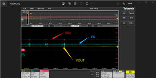

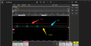

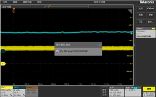

  • Hi
    I measured the EN and VIN,when Vout drops, there is no dip on EN and VIN .The waveform as follow:
    But EN and VIN have noise at the same frequency as LX.The waveform as follow:
    Could it be that VOUT is dropped by noise on EN and VIN?Or is it the noise introduced due to improper test methods?

  • Hey Xinjie,
    Yes, it looks like noise on the EN and VIN line may be causing the part to turn on and off intermittently.  Try installing a 2.2uF capacitor and report the results.
    I also notice on your schematic that enable is connected in two places. Can you confirm this?
    On the right, it looks like you may have a short that bypasses the resistor divider. Is this a schematic error?
    Caleb
  • Hi
    Please refer to the attached schematic.
    4073.TPS53355.pdf

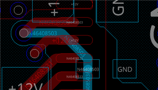

    Yes, sorry for the delay. We have come up with some other ideas as for what's going on. We noticed that on your layout, you have the VREG capacitor on the bottom layer and that there is some distance between the via and the cap. VREG also has a UVLO feature, so if the voltage drops below ~4.20V, the part will initiate a soft shut-down that will cause some of the observations you are making during your testing.
    Can you measure the voltage across the VREG cap (Creg) so that we can see if that is what is causing the UVLO?
    If that doesn't show a drop below the UVLO threshold, I would request that you place one of non-working ICs on the TPS53355 EVM and place it under the same operating conditions. My hope is that this will help us isolate the issue. If issue persists on a TI EVM, then we can move on to something wrong within the IC. If it does not follow, then we can isolate to a potential board level issue. If you need a sample, please ask Cherry.
    Caleb

  • Hey Xinjie,
    TI recommends a minimum of 1uF on the VREG pin. I believe part of your issue is that you currently have your capacitor on the bottom layer. I would recommend you find a way to move the cap to the top layer and as close to the pin as possible. Then you can monitor VREG and VOUT like you did in the picture above.
    Caleb

  • I see that this capacitor is also placed on the bottom layer on the EVM,In other words, it is not forbidden to put it on bottom layer.Thus,why my design doesn't work?
  • Hey Xinjie,
    Having filtering caps on the bottom layer introduces parasitics on the trace and via that could be magnified by the cold temperature. It is not forbidden to have the VREG cap on the bottom layer, but it definitely isn't recommended. Especially in applications with extreme operating conditions such as yours.
    Caleb

  • Hey Xinjie,
    I'm talking about the parasitic inductance and capacitance that they VIA introduces into the signal. Mainly the parasitic inductance.
    Caleb
  • Hi
    How  the parasitic inductance effect the IC?Can you elaborate on that?
  • Hey Xinjie,
    From the perspective of the VREG pin, any parasitic that does not help filter out noise is detrimental to the operation of the IC, as seen in your case.
    For your PCB, I believe the parasitic inductance is coupling on to nearby noise. The fact that your bypass circuit is NOT between the VREG pin and the VIA leads me to believe that the coupled noise is not getting filtered effectively.
    This is why I believe you need the capacitor on the top of the board, between the VREG pin and the VIA.
