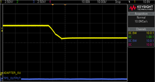

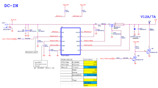

Hi expert,
Customer used TPS24710 and see the Vin has fluctuation during power off. It seems to me the load may drop slower than EN drop below UVLO and energy back drive to input.
They tried to add a cap on EN to GND and no more this symptom.
Would you please advise what might it happened? Is adding the cap workaround good? Any side effect?
