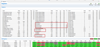

I am conducting an experiment in which I leave a battery pack equipped with BQ40Z50-R1 unattended and observe the amount of self-discharge.
The main SLEEP-related DF settings of BQ40Z50-R1 are as follows.
  • Settings:Configuration:FET Options[SLEEPCHG] : 1
  • Settings:Configuration:DA Configuration[SLEEP] : 1
Since the sleep function of the BQ40Z50-R1 is enabled, the BQ40Z50-R1 spends most of the time in a sleep state during the experiment.
  • BQ40Z50-R1 check open circuit voltage
  • BQ40Z50-R1 checks the current amount
  • My device retrieves data via SMBUS (1time/h)
Lately, I've noticed an increase in the MaxError value.
It increases by 1% approximately every 20 days.
The specific figures regarding 1%=>2% are as follows.
About 475 hours, 19.79 days, +0.05%/day
According to TRM (sluubc1d.pdf, 13.13 0x0C MaxError()), +0.05% seems to be implemented if QMax is not updated for a long time (default 24h).
This matches my situation.
My battery during the experiment was not in RELAX mode, and I predict that no QMax updates were performed.
*This is my fault, but I did not include MAC 0x0056 GaugingStatus when acquiring SMBUS data during the experiment. Therefore it is not possible to check the REST flags
Appreciate your help.

  • Hello, Jose.
    Thanks for your reply.
    I couldn't find a way to attach files on this forum, so I'll include an excerpt of the log at the end of this post.
    The value below is 10mA as the default value.
    DF Gas Gauging:Current Thresholds:Quit Current
    I only have one question.
    I would like to know why MaxError accumulates at 0.05%/day.
    > Essentially the Relax mode is sleep mode as the gauge will enter relax mode when current is less than Quit current.
    Can you think of any other factors? (I haven't logged CycleCount either, but I don't think the count is increasing because it's left without charging or discharging.)
    Hitoshi Okuma
