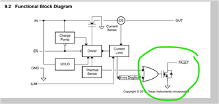

we want to use the TPS2557 for our application because this parts fits perfectly. My question is, is it a must to use the FAULT signal? We don't really need it, So can we simply ignore the pin and keep it disconnected? In the datasheet I can't find this information.

    1, Yes, if you don't need to use the fault pin, you can float it definitely, because it is a open-drain structure, it will be ok.

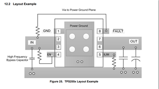

    Compensator out located at the out pins is not defined. Which compensator do you suggest? We want to use 5V with 5A on the outlet. The dev board is limited to 1A and use a 150uF...
    And in the datasheet is written for the PowerPad "Internally connected to GND. Used to heat-sink the part to the circuit board traces.". So is it enough to have copper below the chip, or should we fill the complete PCB with copper to ensure the heat transfer?

    1, For the EN pull down resistance, yes, I guess 10kohm should be enough.
    2, For the Compensator out, you mean the capacitor of the out pin? Right? Recommend use one 0.1nF and one 150uF will be enough.
    3, For the PowerPad connection, you can add copper below the chip, and connect this copper to the whole ground, then you will have a very good thermal performance.
