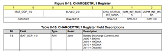

Hey Given,
I will look into this transient for you, but we can only guarantee our parts performance with what is written in the d/s.
BAT_OCP is an internal check that limits the discharge current being pulled from the battery.
Disabling the BAT_OCP just disables the internal check and will not disconnect the battery from the system when there is an over current event.

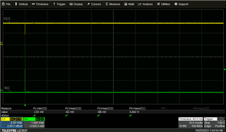

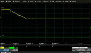

Hey Given,
When testing our EVM setting OCP to 1000mA triggered the over current protection (first image). When we disabled the OCP it did not trigger (second image). Hope this helps!
V/R
Rafael Camarillo
Hi Rafael,
Thanks for your reply.
OCP is setting through REG, but in EC table, there is system discharge current (pulse) which is 2.5A/20ms. Is it hardware protection regardless of REG setting or it is also related OCP setting in REG? If it's disabled, then no such pulse protection limit too? Thanks.
BRs
Given
Hi Given,
The 2.5A / 20 ms that's listed on the datasheet is a physical package limitation. Anything beyond this and you risk damaging the IC physically. It is not tied to the BATOCP in any way.
