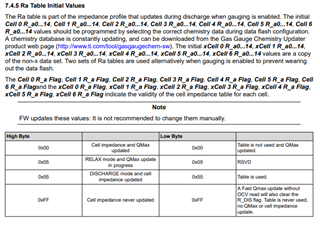

After golden leaning,In the Ra Table in Memory,Cell0 R_a flag,Cell1 R_a flag,Cell2 R_a flag,Cell3 R_a flag all three values are 0055, but Cell4 R_a flag,Cell5 R_a flag the two values are 0000. May I ask this state is learning success.
After golden learning, all flag values are 0055,but after two more loops, the above state is achieved.
