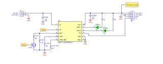

We are trying to use BQ25171-Q1 IC in our design.
I have one doubt regarding one Pin of  BQ25171-Q1  called CHM_TMR So it sets the Chemical of battery and safety timer till here i understood but in table there is option saying Timer disable.
So this Timer disable How does it work ?
How will the IC stop charging if timer is disable ?
Will it be charging the battery until some signal is given to the IC ?
It will be really helpful if someone would give proper explanation
Muhafeez

  • Hi Bill,
    Are you referring to using a external circuit at Iset pin?
     Can you please explain it more ?

  • Hi Muhafeez
    Bill J -- If the device is configured to Li+ Timer Disable (CHM_THR = 62k) it will not end the charge cycle based on time.  Charge current will need to decrease below 10% of fast charge current to end charge cycle.
    Recommend using the 5 hr (100k) or 10 hr (82k) unless your application requires long charge cycles and there is no risk of battery damage.
    The above circuit will change the charge current from high to low.
