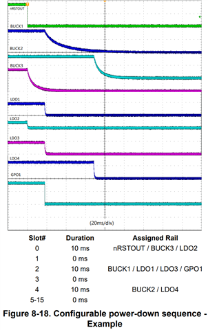

Could you explain below difference between register input and actual results in the datasheet figure8-18?
In below picture, nRSTOUT/BUCK3/LDO2 power down at same time is programmed and it works well.
After 10ms, BUCK1/LDO1/LDO3 power-down is programmed but in the picture, it is around 18ms.
After 10ms, BUCK2.LDO4 power-down is programmed but in the picture, it is around 50ms.
Please let me know how power-down timing is measured.
Thanks.

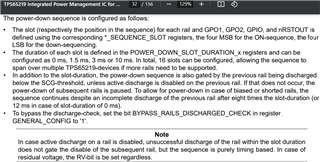

    Thanks for reaching out. The power-down sequence of the TPS65219 PMIC is gated by the following two items: slot duration and rails discharged below the SCG threshold (~260mV).
    The power-down sequence in the scope capture from your previous message shows that nRSTOUT/Buck3/LDO2 are turned OFF first but, after 10ms (slot duration) the output voltage on Buck3 is still above the SCG threshold (~260mV). Once Buck3 is discharged below the SCG threshold, the PMIC continues to the next power-down slot in sequence.
    This PMIC feature that waits for the rails to be discharged below the SCG threshold can be disabled by changing the "BYPASS_RAILS_DISCHARGED_CHECK" register field before the power-down sequence is executed.
