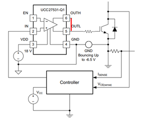

is it possible to directly connect OUTH and OUTL and route this lane to one single gate resistor?
Like in the modified picture below:

Hi Michael,
Yes, you can tie OUTL and OUTH together.
