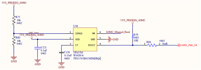

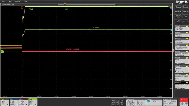

We have used the chip TPS3703B4250DSERQ1 in our design. While testing the board, we have encountered the issue that the reset is not releasing. 5V power line is stable.
Design parameters:
5V0_PREREG_SOM2: 5V measured
SOM2_Manual_Reset: 5V(measured continuous 5V on this line)
SOM2_PWR_EN: 0V measured --> expected 5V here but the chip is pulling down the signal(even after removing R84).
Wondering what could be the problem here. Could it be timing issue?
