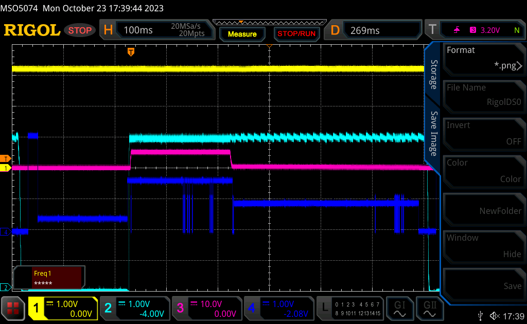

  • Here is what it is behaving connected to ST dev board.
    CH1 - I2C clk
    CH2 - CC1
    CH3 - VBUS
    CH4 - CC2

    What I am seeing in you logs is that for some reason, the phone is initiating a power role swap where the TPS25750 is being changed from a source to a sink and that is consistent with what you are seeing.
    Can you please provide scope captures of the I2CM bus, PP5V, and PPHV into the TPS25750?  It looks like the system is trying to do a power role swap and the TPS25750 is detecting a failure in voltage and disconnecting.  This may be caused by a communication issue with the  BQ25731 and we will need to see what is happening on the communication and input side.

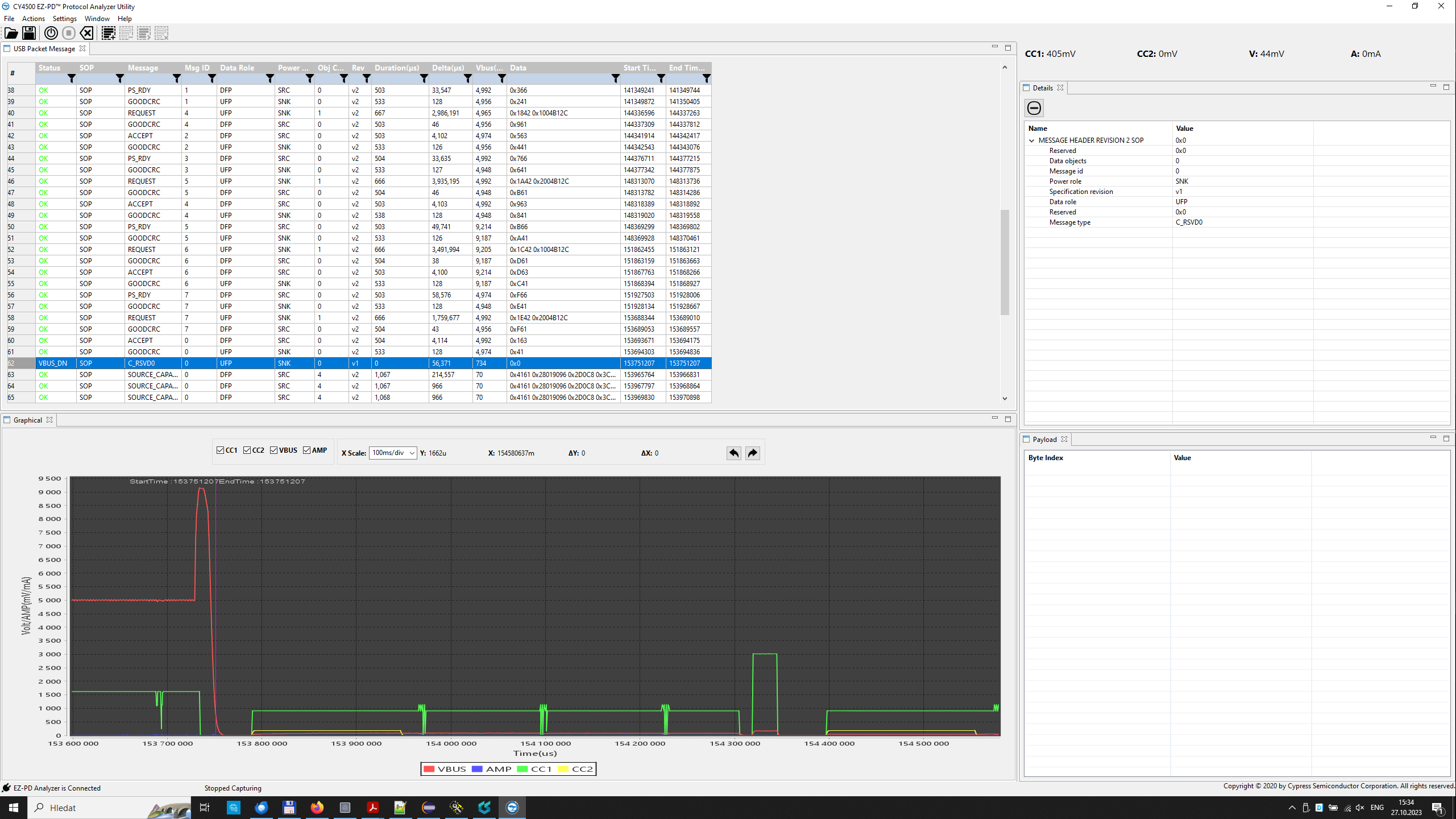

    we proceeded to next step and started to enable OTG/VAP/FRS pin of BQ25731 driven by TPS25750 GPIO EnableSource 73code. All in Source mode.
    At first place we enable OTG output of 9V 3A permanently and try to switch between 5V 3A (cap1) and 9V 3A (cap2) using our ST development board which allows to send Power Source requests to USBC PD Source device.
    We can toggle between modes successfully couple of times, but then we always encounter problem, that VBUS drops to zero after short time after switching to 9V.
    I attach screenshot from USBC PD analyzer from infineon you recommended us.
    Do you have any tips on what is happening?
    Also I noticed through PD analyzer, that setting of Unchunked Extended Message Support + USB Communication Capable + USB Suspend Supported in TPS25750 Application Customization Tool makes no effect as it is always transferred as false + true + true (checked in PD analyzer output)
    Thank you
