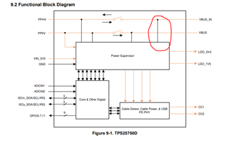

Hi.
I am a bit confused on the dead battery behavior of the TPS25750.
In section 9.3.4.4  of the specification it is stated that  "TPS25750 hardware is configured to present this Rd during a dead-battery or no-battery condition" .
Is this statement always valid or only in NegiotateHighVoltage mode?
I think that in SafeMode the Rd is not present on the CC pins, and therefor the system remains without power when plugged into a USB-C adaptor with PD support.
Is this assumption correct?  Do I have to reconfigure my design to use NegiotateHighVoltage mode and is SafeMode useless for supporting dead batteries?
