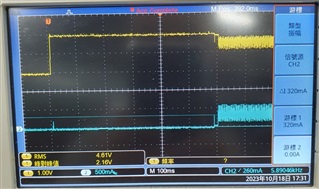

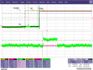

We are using BQ25886 and test poor source qualification.
But when battery voltage is under 3.8V and input source is 5V/0.5A.
The input voltage will drop and under to 3.8V, and input current sink around 700~800mA.
When this moment BQ25886 cannot enter charging stage and STAT pin is blinking.
When battery voltage is over 3.8V, that input voltage and current waveform will become below figure.
When this moment BQ25886 enter charging stage normally.
Our schematic shows below, in this testing VSYS has no load.
Please let us know why the sink current is over 30mA (Ipoorsrc typ is 30mA in datasheet)?

    1. When testing Poor Source Qualification, why is the input current load higher than 15~30mA? The load draw at the moment of measurement can reach 750mA.
    2. When testing Poor Source Qualification, why is the input current load not controlled by ILIM? Our circuit is set to 500mA, why does the load reach 750mA?

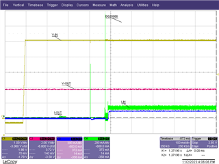

  • Hi
    Couple of things to check:
    1.) Poor Source should be a 30ms pulse about 160mS after VBUS is applied, current will be about 15mA.
    2.) Check the REGN voltage, if you have a Poor Source fail it will not turn on.

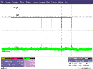

    3.) Also the Poor Source will try 7 time at 2 sec intervals then shutdown, (HIZ Mode)
    Scope Capture of normal start up and zoom in on Poor Source Pulse.
    Scope Capture of fault condition, 7 pulses then shutdown.

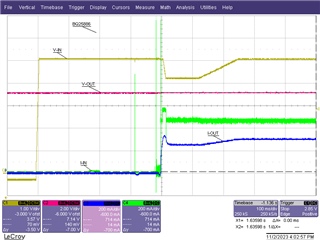

  • HI
    With 5V / 0.5A source we do not see the STAT blinking led stage, see below start up with 7.2V BAT simulator.
    With Reduced battery voltage, 3.8V it is similar:

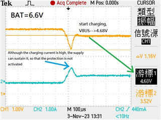

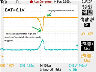

  • Hi Bill,
    According to your experimental results, your VBUS voltage did not show significant drop under current load. This is an ideal power supply. However, the user’s USB interface cannot provide power enough, which will result in the outcome shown in the attached image.
    Pic2 shows that when the charging current is too high, the supply cannot sustain it, and the IC’s protection or reset mechanism is triggered.
    Do you have any ideas for a workaround?
  • Trying to duplicate your test set up.
    Is the scope capture with customer adapter or power supply?
    Checking your test condition on the BQ25886:
    UPDATE --Any jumpers different from factory setting?---I used jumper settings from video for additional test.

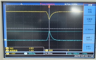

    I suspect the device may be going into UVLO at 3.3V and resetting.  Can you show a wider scope capture that shows when the input voltage dip happens, how long after power is applied?

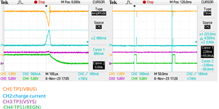

  • Hi Bill,
    Left-side pic is single trigger and right-side pic is continuously capture,
    we notice the period is 220ms.
    The battery has an ultra-low internal resistance of 100mΩ.
    This means that if the IC turns on the MOSFET for too long and does not get a quick response by the current sense,
    the VBUS may not sustain the power consumption, so it starts to drop. This may not be seen by the battery emulator
