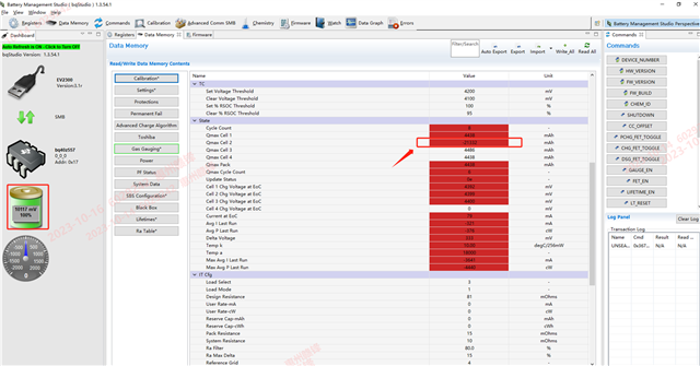

BQ40Z50: BQ40Z557 Qmax cell2 is negative value
Part Number: BQ40Z50
Hi
The End user feedback from the Japanese market found the 1pcs battery was not charging and had no output in the system.
After checking the parameters, the battery has been used for 8 cycles, and the capacity data of the Qmax Cell2 became more than negative 2W, causing the battery power display to be 100 %, the battery cannot be charged or discharged.

Gas Gauging	State	Cycle Count	8	-
Gas Gauging	State	Qmax Cell 1	4438	mAh
Gas Gauging	State	Qmax Cell 2	-21332	mAh
Gas Gauging	State	Qmax Cell 3	4486	mAh
Gas Gauging	State	Qmax Cell 4	4438	mAh
Gas Gauging	State	Qmax Pack	4438	mAh
Gas Gauging	State	Qmax Cycle Count	6	-
Gas Gauging	State	Update Status	0e	-

Please help analyze what is causing the abnormal change the capacity of the battery Qmax Cell2?
Attached the gg file and the figure.

  • Hi Star,
    I have never seen  a negative Qmax value. Per TRM, the minimum value Qmax can be is 0mAh
    DA config is set to 0x16. Meaning this is a 3S application. Why is Qmax Cell 4 updated? What does the cell connection look like?
    Please share the log file that describes this behavior.
