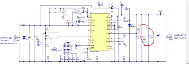

TPS26630 input voltage 48V, output current setting 5A, When the power is turned on, thermal protection sometimes occurs.
The load capacitance is about 490uF.  if the capacitance value is reduced, the protection will not be triggered.
adjusting Cdt/dv will also trigger protection.

    Please reference as below.
    CH1: efuse_output Current, CH3:DC48V_IN, CH4:efuse_output voltage
  • Hi. Kunal
    We have used the TPS26630_33EVM BOARD for this test.
     The EVM board's D2 TVS Diode was removed. The OVP & UVP settings were changed to 60V and 18V.  When no load, the EVM board's output is okay.
    1.  When our circuit (about 490uF) is connected to the output side, the efuse enters thermal protection mode and fails to start up upon powering on, as shown in Fig. 1. & Video.1
    2. Removing capacitor C4 from the EVM board and connecting a large capacitive load also results in power start-up failure. as shown in Fig. 2&  Fig. 3
    (CH1: efuse_output Current, CH3:DC48V_IN, CH4:efuse_output voltage)

  • Hi Sagen,
    1. How much dvdt cap you have tried with?
    2. In addition to load cap is there some other load that is drawing current?
    Kunal Goel
  • Hi. Kunal
     -> Used 22nF & NC on EVM Board Test.
     -> no other load.
  • Hi Sagen,
    Have you removed default caps on EVM? Or you are adding 490uF in addition to these caps?
    Kunal Goel
  • Hi. Kunal.
    If remove EVM 1000uF and connect our circuit with 490uF, that should be okay.
    Regarding the application of this component, we are encountering unstable phenomena. How can we design it to provide a stable output with an unknown capacitance?
  • Hi Sagen,
    There will be a limit to max cap what device can support charging during startup. How much can be the max cap in your case?
    Kunal Goel
  • It is 490uF.  But we still encounter instability situations.
