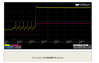

I have question about TPS23731
a. with PoE switch TL-SG1005P V2 that mounted with TPS23731, i noticed multiple retries before the POE enter normal operation. Is this normal? and if Yes, how to avoid this?
PoE block- start up
a. i also tested with PoE switch TSW100000000 (Teltonika) -> Look good! without multiple retries.
PoE block - startup

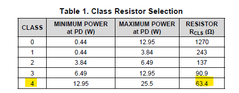

    Looks like both PSE are at/af standard compliant. Could you share your PD schematic? We want to check the classification resistance you set.

    1. Classification resistor R1223=63.4ohm 1%.

    1. The classification resistance looks correct. It may be a problem about PSE. For example, if PSE in semi auto mode, it is is possible to have multiple cycles. You may need to check with the PSE owner.
