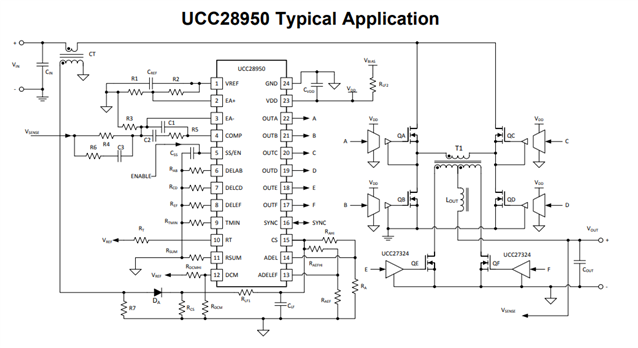

We used that part for dc to dc converter 1000W, i want duty cycle calculation for output regulation,

In the application note equation 6 give an equation for duty cycle.
The EA + is the non inverting input to the error amplifier. The output of the error amplifier controls duty cycle.
If EA + is greater than EA - the output of the amplifier will go high demanding more duty cycle. If EA - is greater than EA + the output of the error amplifier will go low demanding less duty cycle.

The EA + is typically used to set the DC control voltage as shown below. The internal voltage amplifier will raise or lower the comp pin until the correct output voltage and duty cycle is achieved. If EA - is < EA +, COMP will increase to increase duty cycle and the voltage at EA -. If EA - is > EA +, COMP will decrease to decrease the duty cycle and the voltage at EA -.
So if your duty cycle is increasing that would indicate that VOUT is low and the controller is trying to achieve the desired output voltage.
Is this what you are observing?
