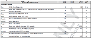

We measure SDA Rise time & SCL Rise time. it cannot meet the SPEC.
I think this LP5009 SPEC is defined by 400KHZ. Our I2C is 100K so it will fail.
Do you have Rise time SPEC for 100KHZ?

Hi Ken,
You can refer the below table:
