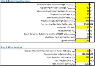

LM5156-Q1: LM5156-Q1 boost converter calculation sheet is something wrong.
Part Number: LM5156-Q1
My design is Vin=8~16,Vout=25,Iout=0.18,eff=90%,fsw=440k current ripple=30% in CCM mode.
The value of ILpk shows 1.53.
Iin_max is 25*4.5/8/0.9=0.68,if the value of ILpk is 1.53,it means the ripple current of L is 0.85,so the ripple ratio is 125%,but my setting is 30%.
