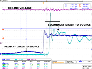

  • In continuation with above post. Today I tested with RCD Clamp with R=550Ohms, C=0.094uF (Though this was obtained for clamping at 230V, with leakage as 2uH)
    The transformer was also changed to ETD49 with primary magnetizing inductance as 3mH. The leakage measured is (Secondary half 1:  464nH and Secondary Half 2:  765nH).  The waveforms obtained are attached.
    There is only one peak which is very sharp at around 350V rest of the waveform is getting clamped around 250V.
    My queries are
    a) Is this a single 350V peak (measurement error)? Nevertheless, the snubber resistance started heating (the power of snubber resistance is around 15W, The calculated value is ).
    b) Will the Loss in the RCD clamp reduce once Synchronous Rectification is enabled? So should I proceed with testing at higher power levels? Presently its around 450W. I need to test at 1500W.
    c) What is the preferred winding arrangement? I am using (Primary Half (15 Turns), Secondary 2 (6 Turns), Primary Half (15 Turns), Secondary 1(6 Turns) with the secondary (S1) closest to the core limb). The primary halves are connected in series.

    Diode D4, D6 and R8 will dissipate all of the leakage energy from the secondary leakage inductance (Lslk).
    The following equation will estimate the power dissipation of the leakage inductance (Pslk).
    Pslk= ((Lslk/2)*(Iout)^2)*fsw

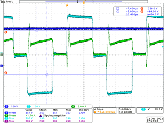

    Sorry for the late reply. During the testing the devices got damaged twice. In one instance the clamp diodes D4 got damaged. I had used 600V,3A SMD ultra fast diode. However, Now i have used 600V, 6A diode with TO-220 Package. Now i am able to get regulation at 48V with input around 330 onwards. However, I am confused whether the delays are correct and whether softswitching is happening. The switching frequency is reduced to 50kHz
    Ch 1: Drain to Source Voltage Primary Device, Ch 2: Drain to Source Voltage Primary Device
    Ch 3: 100V scale: Secondary Drain to Source Voltage, Ch 4: Input Current

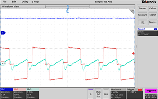

    Ch 1: Input Voltage , Ch 2: Transformer Primary (CYAN)
     Ch 4: Input Current
    Is the transformer waveform correct?
    How do we see if soft-switching is happening , if we don't have access to switch currents.
    what should a DESIGN_1500W_48V_22_12_2023_NEW_CONTROL_CARD_UPDATED_LEAKAGE.xlstypical delay be set. I am presently using the following design values as per attached excel sheet.

    The current in your transformer does not look correct.  Maybe the timing in the SRs is off.  First try to disable the SRs to see if the transformer current improves.

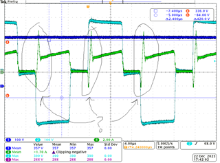

  • What should be the expected shape of the current

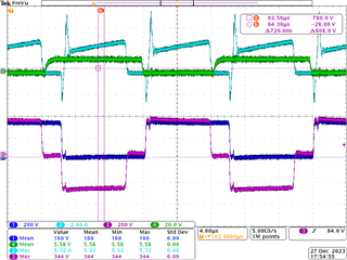

  • Hi Mike,
    I have captured the waveforms, as attached.
    The Delay was kept fixed by keeping KA=0. Also, RDELAB=36k, RDELCD=36k, RDELEF=14k
    Drain_Source_voltage.pdf
    Is the switching correct.
  • The value of RDELAB and RDELCD and RDELEF is increased to 47k, 47k and 23k Respectively
    The gate waveforms of primary side is shown below

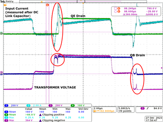

    The current waveform is still showing spike after increasing delay also
    Ch1: Q2 Drain, Ch2: Current,Ch3: Transformer,Ch4: Secondary QE GATE

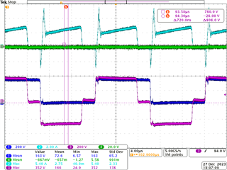

    After disabling synchronous rectification, there is still spike in the current waveform, I am attaching the waveform
    This is after disabling SR more (DCM pin connected to VREF).
    The EVM module from TI is having the following waveform
    what else should be checked to resolve current spike.
    I am reviewing your inquiry and will get back to you shortly.
    Your waveforms look like that the SRs ore not turning off where they should.  That is why you are seeing the spike in current.
    If the SR driver is disabled you should not have an out E or out F.   Your waveform is still showing OUT E is present. If you disable the SR drive I believe the spike should go away.  Also adjust the E and F timing so it turns off during the FET free wheeling period will remove the current spikes as well.

    Were you able to disable the E and F FETs to verify if the issue went away?
