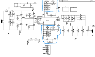

    Do you have a schematic that I can review?
  • The Daugther board is oriented so that the pin matching occurs between that in power board and daughter board.
    I am reviewing your inquiry and will get back to you shortly.
    I reviewed your schematic and it looks like the SR FETs will not be driven in the peak current sense signal is greater than 0.641 V.
    This is based on the voltage set at the DCM pin.
    You might want to to study the error amplifier output, CS pin, DCM pin and Out E pin to see why the SR drivers may not be getting activated.

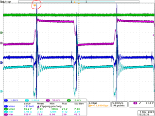

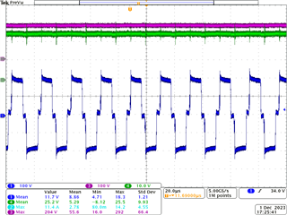

  • Hello Mike,
    There was gate driver issue which was sorted. Now the switches are being driven by pulses. However, there is still negligible output at around 100V. Also the transformer is making some sort of clicking noise. I am attaching the waveform observed in AC side of primary transformer
    It seems to operating in burst mode. However, why are the pulses bipolar.
    The reference document is attached. Here the DCM connection given is different from that mentioned in the excel tool diargram.
    6874.ucc28950.pdf

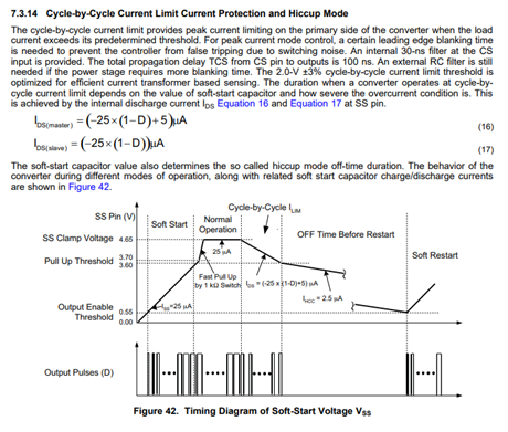

  • In continuation with above. It seems, for when the Input DC voltage is low (20V input) the system is operational (all four primary devices) pulses are there contin uously. After that it goes into some burst mode or some protection mode.
    After the input voltage increases beyond say 35V. it happens to be in burst mode/protection mode.
    What should be the signals I should check for trouble shooting this issue
    I am reviewing your inquiry and will get back to shortly.
    The design is probably audible because it is bursting.  The bursting could be caused by a loop stability, noisy CS signal or poor layout.

             - Make sure the design is not going into over current hiccup mode protection.  The following section from the data sheet explains the cycle by cycle               and hiccup mode over current protection and how it works.

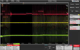

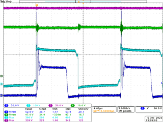

  • Hi Mike,
    In order to test the system, I have changed the sense resitor to get a voltage of 24 V in output. I am  attaching waveforms captured in attached pdf. The load resistance presently used is 4 Ohms. The transformer primary inductance is 2.6mH and leakage inductance is 7uH. I am not using any shim inductance.
    The final requirement is 1.5kW at 48V.
    The key observation is that the transformer voltage is nearly square wave. Once system reaches 24V, any further increase in input voltage the system goes to burst mode.
    Also it is observed that the Gate Voltage of QA starts dipping and then nearly turns of as the system output voltage reaches 24V. I am also attaching updated daughter board schematic values

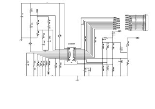

     Experimentation_notes.pdfPSFB_DAUGTHER_BOARD_09_11_2023.pdf
    I have tied the DCM pin to Vref to disable the outputs to QE and QF.
    How to tune the compensator or is there anything else missing/required to be checked.

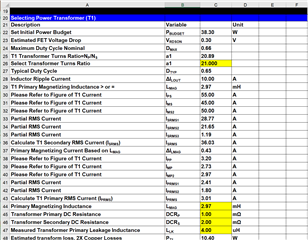

    Your simulation file is setup with a resistor divider that will set the output to 30.86 V.  So if you are trying to get 48 V in your simulation this will need to adjust this resistor divider,  UCC28950_START_UP _PSPICE.pdf
    The transformer turns ratio in your simulation if 5.25.  At 200 V the maximum output voltage achievable would be 200/5.25 = 38 V.  If this is the transformer turns ratio in your design, 48V will not be achievable at 200 V.  So your transformer turns ratio is not correct and will need to be corrected.

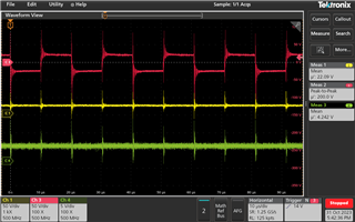

  • Hi Mike,
    Thanks for the reply.The Simulation file i reduced the input voltage to 200V to see whats achievable at that level for the give transformer ratio.I will also put the output capacitor voltage value close to the simulation one.
    Can you go through the document regarding hardware waveforms, here I am testing for Vref at around 24V. However as you may see that the transformer voltage is always squarewave and there is no phase shifting occurring. The COMP pin voltage is near 4-5V.
    As the system is going up to desired test regulation voltage of 24V, what is the issue that it goes into burst mode.
    If your transformer input voltage is a square wave most likely the design is trying to achieve 100% duty cycle.    The comp voltage being at 4 to 5 V is the voltage amplifier demanding a 100% duty cycle.  You need to adjust the transformer turns ratio to support your design. 5.25 is not large enough.

    4. Inside the application note there is a link to the the excel design tool.  You can find this link below.
       a.) The calculations are based on the application note
    https://www.ti.com/lit/an/slua560d/slua560d.pdf
       b.) You enter your design parameters in yellow
    c.) The excel will then calculate the component values you need for the design in white.
    You select components for the design within +/- the calculated vales.
    d.) This tool will also compensate the voltage loop for you as well.

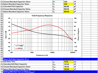

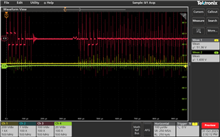

  • Hi Mike,
    I have changed the loading to around 30% . ie 12A at 36V output. Please note I have changed the desired regulation level to 36V for scaled down testing.

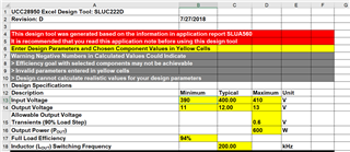

    However, the system is still going into burst mode. I am attaching the Excel tool
    Please note that the DCM is tied to VREF and the delay resistances are kept at 90k each for RAB,RCD and REF.
    The compensator resistances are
    Rf=120k
    Cf=3.3nF
    Cp=330pFPSFB_DESING_36V.xls
    What are the other issue for the system going to burst mode (in non-synchronous operation) apart from light load operation.

    The excel file you have attached is setup for a 12 V output.  Is this correct excel file you meant to attach?
    If the loop in not compensated correctly you could run into stability issues.  This generally will show up as ringing and not bursting. Or sinusoidal oscillations.
    I don't think this is the issue.  However, you should compensate the  loop based on your input and output power requirements.  The excel tool will help you compensate the voltage loop.
    If you did not change your transformer turns ratio in your design to regulate 36 V at 200 V would require 95% duty cycle.  If you are at 30% load you should not be hitting light load burst mode.  However, you could be over current hiccup mode protection.  This is also a burst mode protection.  The following describes how hiccup mode protection works.

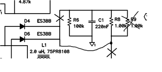

  • Hi Mike,
    Thanks for the reply. As you suggested, the system was going into over-current hiccup mode,even thought the loading was less than design value (48V, 1500W).
    The CS network filtering resistors were change to incorporate higher filtering C7=3.3nF and R22=2.2K
     The CS sense resistor R3=22 Ohm, R4=2.2k

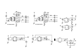

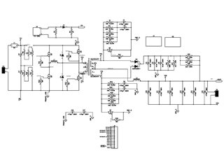

    What could be the reason for this failure. I am attaching the schematic and the power board layout for your reference. I could not capture any waveform at the time of damage to device. Is this issue due to ringing as there is no softswitching occurring at light loads.
    SCHEMATIC_LAYOUT.pdf
    Your current sense resistor is R4 and R3 is used to reset the transformer.
    In other words R3 = 2.2 k ohm and R4 = 22 ohms.   This is correctly represented on your schematic but you had mentioned the values were reversed in your response.  Could you double check this?  If your current sense transformer is not setup correctly this could cause your FETs to be damaged.
    FETs to fail due to electrical over stress.  The causes will either be thermal, over voltage and/or over current.  You ruled out thermal and if the input was only 200 V more than likely it is over current.
    You mentioned that your CS filter capacitor was 3.3 nF and R22 was 2.2 k ohm.  This has an RC time constant of 7.26 us and a low frequency pole of 21.9 kHz.  This is too much filtering and could prevent the cycle by cycle current limit from protecting the FETs, which can lead to FET failure.
    I recommend set this RC filter pole at 10 x the switching frequency on the output inductor.   The most popular value is 1k ohm and 220 pF this puts the low frequency pole at 723 kHz roughly with an RC time constant of 220 ns.
    Your E and F FET timing could also be off which could cause your primary FETs to be damaged.  I would recommend designing with a fixed delay approach and adjusting the turn-delays at 10% load before going to full load.  Application note slua560 reviews the step by step design process of designing a PSFB with the fixed delay approach.  It gives calculations for initial delay values and tips on how to fine tune the delays based on 10% loading
    https://www.ti.com/lit/pdf/slua560
    I recommend the following.
    1. Check to make sure R3 and R4 values match the schematic.
    2. Fix the RC filtering on the CS pin
    3. Make sure the cycle by cycle peak current limit is setup so the maximum FET current is not exceeded.  I would recommend setting the maximum limit at 80% of the maximum FET rating.
    4. Use a fixed delay design approach and setup turnon delays at 10% loading based on application note slua560.

  • Dear Mike
    Thankyou for the reply.
    I am attaching the schematic and layout for your review. I have tied DCM pin to VREF to disable synchronous rectification.
    DipTrace Schematic - PSFB_DAUGTHER_BOARD_09_11_2023.pdf8231.SCHEMATIC_LAYOUT.pdf
    Thanks & Regards
    I received your inquiry and it is under review.
    Thankyou for sending the schematic and layout for review.
    I had also asked you to double check your current sense transformer feedback network to make sure it is working correctly.
    Did you do that and can you share the results?
    Does the CS signal represent the proper FET drain current?  If it does not it will not protect the FETs.
  • Hi Mike,
    I am attaching the current sense network voltage and also actual current.
    CH1: CS pin voltage
    CH2: Current Measured
    Ch3: Drain to source voltage of Primary Switch
    Ch4: Output Voltage
    Its observed the current spike is going to higher level about 10A. However, the flat level is around 3 A or so.
    CH1: Transformer voltage
    Ch4: Output Voltage
    Its observed the current spike is going to higher level about 10A. Howver, the flat level is around 3 A or so.
    As it reaches regulation voltage, some noise is observed from transformer side.
    The devices are rated for 650V and 44A.
    Earlier, I think the devices were damaged due to ringing.
    It is seen that around 130Vin, the Output reaches 24V. Now should I directly apply Vin=200, or ramp Vin from 130 V to 200 V and above.
    The load is around 300W.
  • In continuation with above, as there was current spikes during switch transition, I increased the low pass filter Capacitor value to 1nF of CS network. Now, the system seems to be regulating as the transformed voltage is now showing decrease in pulse width when the input voltage is increased.
    However, the secondary snubber circuit resistor is getting heated. I am attaching the specific resistor in circuit diagram. Is there any design process for selection/design of snubber or what else is the issue.
    Also Presently, I have disabled synchronous rectification, should I enable it now or enable it after resolving the secondary side snubber circuit issue .
    DIPTRACE_PSFB_QUERY.pdf

    I reviewed your waveform and the CS pin is a 500mV when the drain current is at 2.5 A.
    The way your CT is setup the controller should go into cycle by cycle current limit when the drain current reaches 10 A and the CS pin reaches 2V.
    So it seems that your current sense transformer and CS resistor are selected to go into cycle by cycle current limit at 10A.
    You have these leading edge current spikes in the drain of the FET that should not be there.
    On the below waveform it is roughly 8 A.  This indicates that an SR is on when it should not be.
    This could indicate and SR timing problem.
    I would disable the SRs to see if you can remove this leading edge spike.
    The below waveform that you took shows that peak current every other switching cycle is at different level.
    This should not happen in peak current mode control.
    You used an RSUM resistor of 130 k which should give you a slope compensation of 40 mV/us roughly.  For a 10 us period this give you a slope compensation ramp max of 400 mV.   So your slope compensation is setup correctly.  This issue is most likely a small signal instability.  You should recheck your voltage loop compensation.
    In your last correspondence you had mentioned the snubber resistor was getting hot?  Could you tell me which resistor are getting hot?  You have snubbers across the SR FETs and a RC clamp on the output.
  • Hi Mike,
    Thanks for the reply. Up till now all the waveforms taken don't have any Synchronous rectification.
    a) I have put in red rectangle. the resistors which are getting hot, I have used snubber resistors as 1206 package.  Is it getting hot due to lack of synchronous rectification. What is the design process.
    b)Also I have put in my last post, that now system is look to regulating the output after putting the filter capacitor of C=1nF in the CS network.
    c) Should I change the feedback capacitor , so that regulation is nearly correct at 48 V at say 50% load and then turn on synchronous rectification or should I valid date synchronous rectificaiton at 24V and then proceed to testing at 48V.
    If those resistors are getting hot they are dissipating too much power.
    I would recommend using a traditional RCD clamp on the output which dissipates less  than is used in the evaluation module.

  • Hi Mike,
    Thanks for the reply. I am not testing with output of 48V and load around 450W. The design target as mentioned earlier is 1500W,48V.
    As you suggested I changed the RCD Clamp to R=10 Ohm, C=470nF, and Rparallel to C as 68k. However, I am not sure if its optimized.
    I am attaching the waveform of secondary drain to source voltage, when the output voltage is at 48V. and Input at 340V.
    The devices used in secondary side is also same as that used in primary. (Rated at 650V, 44A).
    However, the secondary snubbers are getting heated (after running for around 30-40s)
    I am using SMD resistors and cap (1206) package. Should I increase the capacitance to mitigate ringing. Also how to manage the heat dissipation.
    In primary also I had to use snubbers (1nF, 22Ohm/2W). This also gets heated after 30-40s.
    What should be done to reduce heating in snubbers, how do I validate soft switching is happening.
    The waveforms along with primary and secondary drain to source and input voltage, output voltage is attached for your reference,
    Ch 1: Secondary Side Drain to Source Voltage
    Ch 2: Primary Side Drain to Source
     Ch 3: Input Voltage
    Ch 4: Output Voltage

    I am not sure if your RCD clamp is setup correctly.
    The voltage across the 68k ohm and 47nF should be 48V.  Iout = 450 W/48V = 9.375A.
    I will estimate the FET peak current is Iout*1.3 = 12.2A
    The clamp would clamp the voltage at 48 V + 12.2A*(10 ohm) = 170 V.
    In your design the voltage is ringing up to 430 V roughly.
    So the 10 ohm resistor may not be the correct value.  I would check that.
    Your RC time constant might be too large.  If this is the case decrease the C in parallel with the 68 k ohm resistor.
    I have had good luck with an RC time constant of 511 us.  Your time constant is roughly 32 ms.
    Your RC snubbers across the synchronous rectifiers don't seem to be providing any dampening for the ringing.
    This ringing is caused by the switch node capacitance and the transformers secondary leakage inductance.
    The following application not was written for flybacks.  However, the section on setting up a snubber across the output rectifier in the flyback would also apply for setting the snubber across the SR in your application.

  • what should the typical range for the Resistor R8 in attached figure also what is the VD6 assumed.
    I assumed Vfet as 250V (even though presently I am using higher rated device). VD6=1.5V, Vout=54 V( Max)
    This is the equation
    Is there something wrong in assumtion.
