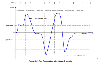

I see two relax modes in 《Technical Reference Manual》, and they conflict。
1、Current < Quit Current for Chg Relax Time period or Current > (–) for Quit Current Dsg Relax Time period will enter relax mode
2、A relaxed state is achieved if the battery voltage has a dV/dt of < 4 µV/s.
Are these two relax's different? The first is that it is impossible to reach dV/dt of <4 µV/s。
One more question:
“These OCV readings are taken when the battery is in a relaxed state before and after charge or discharge activity” This OCV is the second relax,How do I know that OCV readings are taken and that OCV is valid?
  • Hello Sunrain,
    1- Both conditions apply for Relax mode. The gauge uses absolute value for when current is negative. See 6.3 Gas Gauge Modes in TRM.
    2- The dV/dt of < 4 µV/s condition is used for OCV measurements, not to determine when the gauge enters Relax state.
    The VOK flag indicates the OCV measurement is valid. See below.

    1、The GaugingStatus()[REST] flag is set when a valid OCV reading occurs;
           How do you know the two ocv readings are taken?
    2、The [VOK] flag indicates the last OCV reading is qualified for the QMax update.
         If [REST] is set and [VOK] is cleared, but there is no QMAX update. So is this valid OCV reading is disqualified?
  • Hello Sunrain,
    1- If you are logging, when you see the VOK flag toggling twice, this indicates that two OCV measurements have occurred.
    2- I see the confusion, not all OCV measurements qualify for Qmax update. When VOK is set, it means it qualifies. The gauge takes OCV measurements every 1 hour in relax mode.

    If it is the first Qmax update, 90% of passed charge is required. Please see below for all QMax update conditions.
