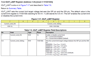

Hey all,
Can this device be operated in a constant output current mode? If not is there a buck-boost that can be?

Hi Robert,
Thanks for reaching out.
May I know what is the application here?
Yes, this device can operate at CC mode, you can program the output current limit in the Iout_LIMIT register, then it can work at CC mode with Iout=(Visp-Visn)/Rsense.

Hey Bryce,
Thanks for the response. The application is for charging a super capacitor bank as an energy reserve system.
